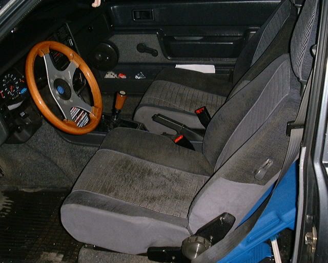

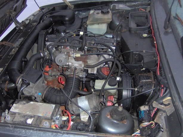

Ok,new and fresh winds are blowing to my project. I have bought back my former 340 GL B172K -87
Here`s the deal:
-Volvo 340 GL B172K -87
-Volvo 360 GLT B200E -87
=Volvo 340 GL(T) B200E -87
I´m doing engineswap between those and also all technic will change included rearaxle, transmission, kardanaxle, engine, exhaustpipe, electricity, fuelpiping.
This is my first engineswap so most of this is new to me. I`t`s all about learning
Pics:
340 GL which is going engine transfer
360 GLT organdeliver
Here we go...
