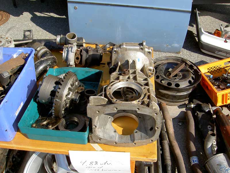

Here som pictures off the modded 240 diff (4.88) and the rearaxel

Would you mind telling me what has been changed on this diff? I can imagine that the ring and pinion must have been switched over to the 360 housing, but otherwise?
BTW, would you still be able to reach decent top speeds with a 4.88 end reduction (final ratio)? The 360 has 3.44 stock I think.

Hello.
Its not my diff on the picture. Its a old  member how had made it from a 240 4.88 diff. I think its orginal diff but have som few changes.
You need to make room for it in the diffhouse. Its not going to fit becaouse the bult´s. You can see on the picture how he made the diff to fit the 300 diff house. See how tight its going to be, the bults scraches the diffhouse wall after the work on the diff. But it works. He drives rally with this setup.
No you are not going to reach decent top speed.. depending on what you mean with decent.. on my stock Volvo 360 GL with B200F and max rpm ~6100rpm the car would top about 163km/h at redline.. close to 100mph  ::)
But you can ofcourse go for another final ratio.. dont know what that 4.88 is coming frome.. maybe from rallying.
This case with modding the original housing of differential is one way to go.. another way is to take a hole differential with housing from a Volvo 240 and take away the shafts.. (dont know what they is called in english) and the "tubes" that the shafts goes in out to the wheels
then bolt on the shafts from the Volvo 360 and modificate the connection to the gearbox and make new connections to the body..

« Svar #9 skrivet: april 17, 2005, 15:34:48 »
Here is my only picture of the modified 240 LSD that was modified to fit a Volvo 360 that was used in Rallycross here in Sweden.

he breaks diffs every other event with a standard 2.0l motor !!
Iv'e been reading the posts about modding the DANA 30 diff into the 360 casing , [ on here and 300 mania , voc forum ] Very interesting stuff .
It's very similar to what we do with a Ford Transit Diff into Ford English Axle[escort etc]for ford english axled trials cars
Looks very promising , ONE problem which doesn't seem to have been adressed on this mod [please put me right ! ] is that the gearbox shaft on the 360 fits inside the pinion [which is hollow and splined ] on the 240 etc from which the DANA would be sourced are the pinions not flanged to the prop and solid ?
The pics of the modded casing and diff on  showes the pinion as solid , how does it fit to the gearbox shaft ?
Any pics of the front end of the casing showing the coupling ?
Cheers
Carl
fille
  • Antal inlägg: 273
  • Borta bra men i garaget bäst!
SV: 360 LSD?
« Svar #28 skrivet: november 28, 2007, 16:01:30 »
det går alltså ner en 240 diff i 300 huset om man slipar lite? Måste man byta pinjong med eller är de samma? är de nå mer man behöver göra än att slipa så att 240 difen får plats?
mvh // Fille
Bygger ny tävlingsbil
SV: 360 LSD?
« Svar #29 skrivet: november 28, 2007, 19:09:29 »
mvh // Fille
Som du kan läsa i inlägget på engelska ovan så är 360-pinjongen ihålig och invändigt splinesad en bra bit in. 240:s pinjong är inte sådan vill jag minnas.. den jag har från min 245 turbo är bara gängad i änden, utvändigt.
fille
  • Antal inlägg: 273
SV: 360 LSD?
« Svar #30 skrivet: november 30, 2007, 20:29:34 »
ni får ursäkta min dåliga engelsa kunskap :P
 vad menar du frej?
måste man byta pinjongen med eller går de å köra med orginal 360?
SV: 360 LSD?
« Svar #31 skrivet: november 30, 2007, 21:15:10 »
vad menar du frej?
Jag menar att man MÅSTE ha en pinjong från en 360 för att den ska passa på 360:ns växellådas utgående axel som sticks djupt in i själva pinjongen när man sätter ihop dem! Men om den passar i nåt annat hus än 360:ns diffhus det vet jag däremot inte. Men bygger man in en diff från annan bilmodell i 360:ns diffhus så borde det funka.
fille
  • Antal inlägg: 273
SV: 360 LSD?
« Svar #32 skrivet: november 30, 2007, 21:39:20 »
oki ska försöka få tag på en 240 bromsad diff då å maserra in ui orginalhuset.
